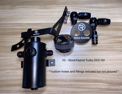

  • Son PCV delete Kit ist schon auffällig :D
    Ross Racing B58 Billet PCV Breather - V2 | Ross R Performance
    **Cross thread damage is not covered by warranty. Threads are tested before shipment to ensure threads are correct.** **Refresh page and select again if…
    www.rossrperformance.com
